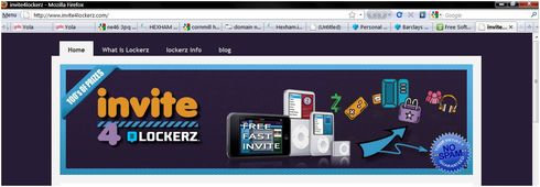

It shows a site on that URL for me (see below)
I presume you didnt actually change the name servers but you changed the ANAME records.

Inappropriate?Hi myinvite4lockerz,
I can see your site on this link: http://www.invite4lockerz.com/. Can you click on it and confirm that you are able to see it?
