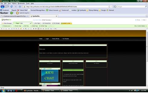

Hi, I also get this problem. What happens is the drag and drop the textbox component where you want it. add what you want save and leave the page come back and it is bigger than before, Than to undo it you have it click it or 62% delete a few lines you did not create.
When this happens again i will post a screen shot
I’m confident

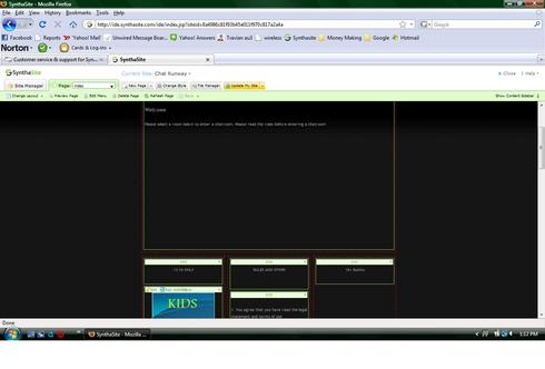

Inappropriate?Ok it just happened to me again here is a screen shot (Before and arfter)
I have just saved and gone to edit another page
I have saved the other page i was on and i have returned to find this

Inappropriate?Hi Guys
This is a bug. You are correct: it is annoying but does not affect your actual site. We are working on it and hope to have it fixed soon. Please bear with us.

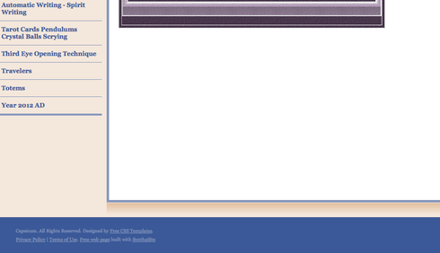

Inappropriate?Mine appeared immediately, and most of my articles are double spaced now, even though I'm not wanting them to be. There also is another issue, my Navigation Bar seems to be in a larger font than I would want, and towards the bottom of the screen, about 3/4ths the way down, the Synthasite banner is cutting across my screen blocking several of my Navigation Bar links. http://hopefrombeyond.synthasite.com I can't find where to make smaller the font size on the Navigation bar or stop this Synthasite from being in the place it is, rather than where it should be which is at the bottom of the screen.

I'm really sorry you are having this problem. I have taken a look at your site using the Firefox browser and it looks ok to me. Can you please tell me what browser and operating system you are using. I will post a screen shot of what I am seeing at the bottom of your page; the page is very long so it is difficult for me to paste the whole thing. It would be great if you could post a screen shot of how it is appearing for you.

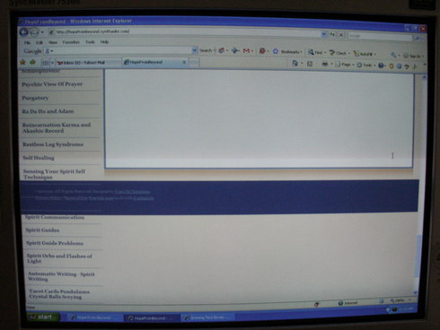

Inappropriate?Here is a screen shot of the problem when using Internet Explorer:
Notice how it is cutting across the screen up where it shouldn't be. This blue banner with the synthasite links should be at the very bottom of the screen with any browser. The picture is of the Index page: http://hopefrombeyond.synthasite.com

Hi LilyHFB,
I am checking into this and will get back with you when I have more information. Thanks for posting the screen shot.
Emmy -
This appears to be a bug with the style and will need to be looked at further by our engineering team. I'm sorry for the inconvenience and will let you know when I have more information. We appreciate your patience as we work on this. -
Hello,
This is a bug, and although I cannot give an exact time as to when a fix will be deployed, there is something you can do to remedy the problem in the meantime. The problem is that the footer will go at the bottom of wherever your content ends. If you put a text box onto your page and hit the Return or Enter key a bunch of times it will move the footer down the page. I hope you can use this as a workaround until a fix is in place.
Kind Regards,
Emmy -
