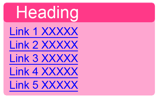

Inappropriate?Can anybody give me a code/tutorial/instructions on how to make the some text, with links, having a background colour(/texture) with heading(also with background and link)
I dont think i have put it in words very well, so i have made a model picture of what i want, have a look

Inappropriate?Hi Monica,
Hope this will help you.
<!-- <style type="text/css">
.beauty_tips {
background-color: pink;
.beauty_tips .title {
font-family: Georgia, "Times New Roman", Times, serif;
font-size: 1em;
letter-spacing: 0.5px;
color: #ffffff;
border-bottom: 1px solid red;
background-color: red;
.beauty_tips .desc {
font-size: 12x;
display: block;
.beauty_tips .desc a {
text-decoration: none;
color: orange;
.beauty_tips .desc a:hover {
text-decoration: underline;
color: orange;
.beauty_tips a {
color: green;
.beauty_tips a:hover {
color: green;
</style>
<div class="beauty_tips">
<p class="title">HEADING</p>
<p class="desc"><a href="#">LINK 1 - no underline</a></p>
<a href="#">LINK 2 - with underline</a>
</div> -->
Remove "<!--" and "-->" at the beginning and at the end. Change the font size and color to the one you like. Place the css script at the every beginning of your page.

Thanks alot Niddy.. I will surely give it a try. Thanks once again :) -
