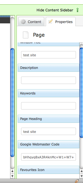

Inappropriate?After you sign up for a Google Webmaster account and type in your URL, here are the steps you should follow:
1) Select the meta tag verification option. Here is an example of what you will see:
<!-- <meta name="verify-v1" content="bHhqyg8xA3R4knMc+W1+W7+U0/Fy2EBT580Jbxdtx8I=" /> -->
2) Copy only the long letter and number string you see between the quotation marks. The one above is for an example and you should replace it with your own.
3) In SynthaSite, click on the properties sidebar and paste that code in the specially designated "Google Webmaster" field. Do this for every page of your site that you want Google to track.
4) Republish your site and check back with Google Webmaster to make sure that it has been verified

Inappropriate?Thanks for the info
I pasted
I/hRYBGsxkzbI1SSOZre7UAez8M6yWfevoYozC9vVDQ=
into the webmaster bar,will reply when it works again =)
ps. I am a bit unsure about the = at the end of the code,should it be added as well?
my "meta tag code" was:
<meta name="verify-v1" />
but I only used the phrase you suggested.
Thanks again =D
I’m happy about information support on synthasite!
Inappropriate?Great!it works!
