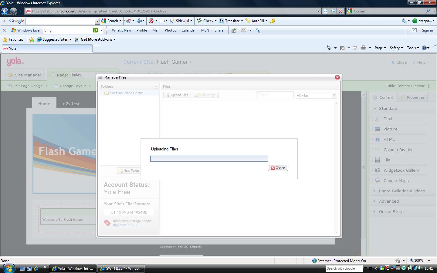

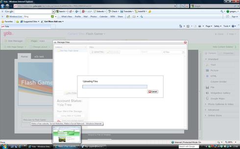

Inappropriate?How big is your file? Yola free allows file sizes up to 15MB. Perhaps it's too large?
Inappropriate?this is wierd but it sais 0 bytes
but i can play it through a direct upload flash player but i want it on my site not on another -
Hi Gregory - is the file 0kb on your computer? If so, then there's possibly something wrong with it. Could you please send an email to support@yola.com and attach the file so that we can take a look for you?
