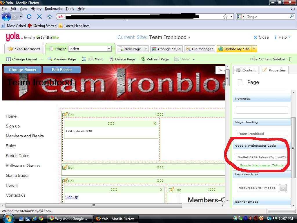

Let start at the third screen in the Tutorial:
The actual relevant code causes a lot of people confusion: It's as the image demonstrates simply that section between the quotation marks including the = sign.
You then simply paste it into the area marked in the builder. labelled Google Webmaster Code
Now return to the Webmaster verification page and click Verify
\If this is successful a message will appear with a golden aura. If this isn't successful. Click the Verify button again. Google often fails on first attempt presumably due to load.
If this still hasn't worked for you. Please get back to us here and we'll review again.. i'm fairly confident that this will be successful and then you are on to the next step of submitting a sitemap.
I wish you luck with this and will wait to hear your outcome.

Inappropriate?Hi Christina,
i think i've seen the reason why.
The "=" sign hasn't been included in the code
"hmFdxwAPmBz+4XQcRF0tX2bGGZKjrC3kZ8TU3dtlb8M"
It should be:
"hmFdxwAPmBz+4XQcRF0tX2bGGZKjrC3kZ8TU3dtlb8M="
So the easiest way to remedy this is to simply go into the properties sidebar. Google Webmaster Code and add the = sign to the end of the string
There's still a problem. What you have added is the content including the quotation marks.
You only add the characters between the quotation marks including the = sign, but not including the quotation marks them selves as I can see you have added.
So the string that you must capture is:
uh6mprBY0L2KM8mpyi9ehagGyQRpqqDEcREYCC7aKn4=
I know this is very frustrating for you but you're nearly there I feel. -
