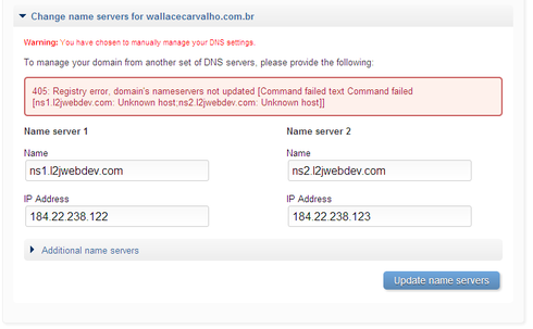

405: Registry error, domain's nameservers not updated [Command failed text Command failed [: Invalid IP address;: Invalid IP address]]
  • 2
  • Problem
  • Updated 8 years ago
  • In Progress
My domain does not want to accept the DNS. but the host is already running, what do I do?
that's error:

These are the old IP Adresses
ns1.wallacecarvalho.com.br
iP1:184.22.238.122
ns2.wallacecarvalho.com.br
iP2:184.22.238.123
I asked for support to rebuild cpanel host with new DNS,
and these are the new addresses
ns1.l2jwebdev.com
iP1:184.22.238.122
ns2.l2jwebdev.com
iP2:184.22.238.123
but the DNS don't work
and the host server it's mine !
Now give this error
405: Registry error, domain's nameservers not updated [Command failed text Command failed [ns1.l2jwebdev.com: Unknown host;ns2.l2jwebdev.com: Unknown host]]
but the DNS was recorded in less than 24 hours, then I think that may be why still not working
