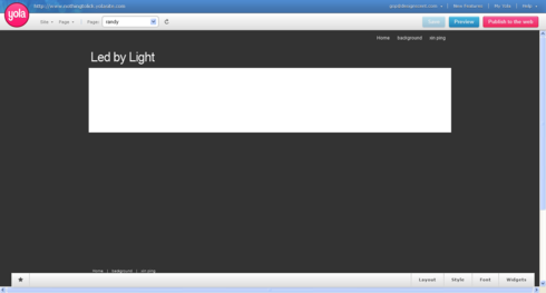

Photo of Gop
Gop
  • 7473 Posts
  • 2115 Reply Likes
Hi pravans,
Here is the Modern Interiors Style/template with the banner removed completely.
The white area I've left as it shows you the canvas or content wrapper where you can add anything including an swf movie. The length of this space isn't restricted, it grows to fit your content. As I said this is everything removed but can be modified a little bit if you still want things to be apparent. I can only see if this would work for you. Let me know and I'm happy to pass on the code etc.

Photo of Gop
Gop
  • 7473 Posts
  • 2115 Reply Likes
Do you want this for each page or just simply your index page?
You obviously have Yola Silver.
The answer to this question dictates the way I present the code to you and the instructions for placing it.

Hi pranvans,
I have seen your other thread and want to say I'm sorry for the delay which coudn't be helped.
Here's the code to remove the banner associated files leaving you with a blank area to add your swf file.
#sys_banner {
div.ys_banner_wrap {
div#sys_background {
div.ys_top_shadow {
You can simply add this to your CSS over-rides and it will make the changes across your complete site.
