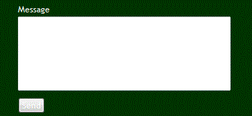

I love using Yola BUT I am experiencing a serious issue with support! This is day 3 of communicating with Yola and my issue has not been resolved It is clear that the support person is NOT reading my message. I really need help asap!
This is my issue:I have a CONTACT us widget on our page at http://www.hwsolutions.org/contact-us... and I have explained CLEARLY to the support person concerned that text entered into the MESSAGE block (block below the lines where you put in your details, and below the Phone block) is white hence it is invisible (white on white).
Can anyone assist me with this please?

I had a look at your "Contact Us" page and see that problem you have with entering text into the Message box on the form. This is indeed frustrating.
I also had a look at the web code on your site. It appears that you have edited the site CSS and added all the site code into the left pane of the CSS editor. This is the area you would usually use to add CSS you want to use to customize your site's stylesheet. You should only be copying the CSS you need to tweak and not other non-CSS code or text such as :
window.jQuery || document.write('')
This will cause your site to behave inconsistently and may be the cause of your contact form's message box not working as expected.
As a first troubleshooting step, please remove all the non-CSS code from the CSS editor.
Once you have done this, please publish your site and test the form again. If you still have problems with it, we will take a closer look at the form and see what else may be causing the issue there.

When I check your Yola account and the Site CSS of your website, I can see that there is still the complete original code in the left-hand side overrides field, and there are error messages at the top of the overrides field which indicate that wrong code was added to the field.
When I temporarily disable your CSS overrides by checking the check box in the bottom left corner and then navigate to your Contact us page in the Preview box, I notice that when typing into your "message" field, the font colour is no longer white, but dark as when typing into the other fields of your Contact Form.
This means that there is some error or double coding in your CSS overrides box which needs to be removed.
