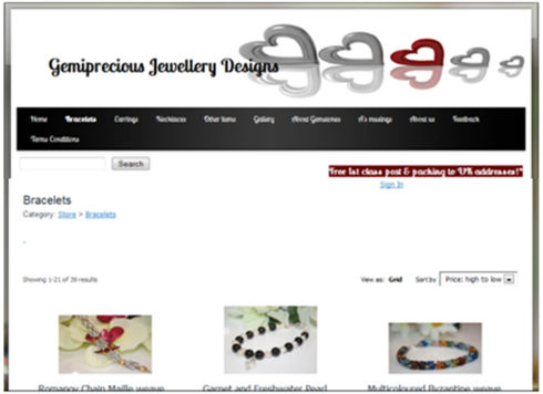

Hi
I have some white space at the top of my pages on www.gemipreciousjewellery.co.uk., the bit between the Category title and the pictures starting, see below:
I am a bit more confident with HTML, although I would need step by step help to find the right area, but am nervous about changing an CSS.
Any help would be gratefully received as would any feedback on my site so I can improve it.
Many thanks

Hello A,
Is this only occurring on your "bracelets" shop page? I can see the reason why but I can't see it on your other pages.
I'm using FF as my browser.
Photo of A
A
  • 87 Posts
  • 1 Reply Like
Hi Gop
Yes I am also using FF and it does seem to be only on the bracelets page which makes it all the more annoying, and to my mind looks unprofessional.
Any ideas why this is happening?
A
Photo of Gop
Gop
  • 7473 Posts
  • 2115 Reply Likes
Hello A,
I have found an addition of code on your page which is causing the issue. I am not sure where it is though because it's occurring in your store styling and that should affect every store page.
Have a look for this in your store CSS and if you find it remove it and check the outcome. It doesn't really do anything except add the hyphen and a blank line only on that page???
<div class="ecwid-productBrowser-categoryDescription">
<div class="gwt-HTML">
<p>
</div>
</div>
If you can't manage this then please send me an email and we can work on this together if you like? gop@designscent.com
