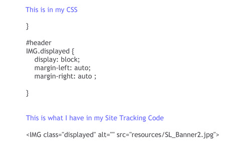

Still not working, I'm sure it's my CSS - right?
See image attached ;)

Summary: we know that the syntax works so there's something else interfering. Wondering if there is a duplication of the class name IMG?
One way of trying to see if that is the case is to use a different class name and something that isn't used elsewhere. Suggest COMPANY. So simply replace IMG with COMPANY in both places and see how that goes.
The slider has a number of styling elements and I guess this may be interfering with the CSS interpretation??

Oops. I got that wrong. The class name is "displayed" so back to where you were and change "displayed" for "shown". That works on the trial site I indicated.

I changed both CSS and HTML in Site Track from displayed to shown
no change... I will try some variations.
