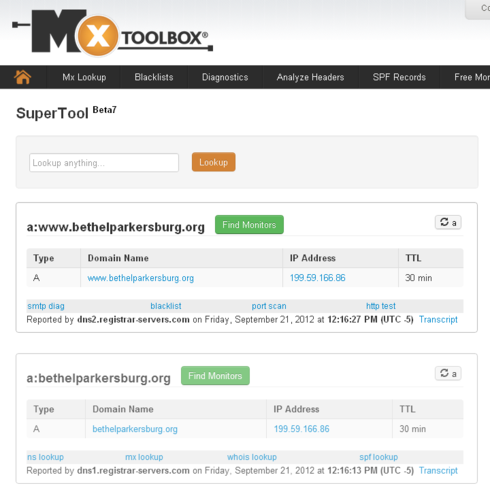

There is something going wrong with the propagation of the records. Here's a shot of the DNS settings looked at with a third party tool.
This is being updated every 30 minutes so there's something wrong between the origin and the propagation. Yola would be picking up on the same data but the IP's are wrong.
Can you just see and capture the DNS settings from your registrar's DNS and see if it's holding the new settings or dropping back to older settings?
