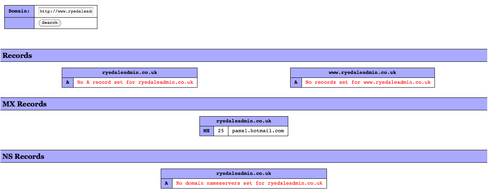

Hi Lisa,
When looking at your domain settings, I am seeing the following
If you have changed your A Records to point to Yola's IP ( 184.72.229.176 ), there is a chance that they are still propagating. Please keep in mind that this propagation can take up to 48 hours.
In order to publish your site to this domain, you will need to add an A record to the www and non www version of your domain. Let's give it a bit more time and see if the records propagate. If you are not seeing them, please go ahead and touch base with your registrar sharing the information I have provided above.

Hi Lisa,
You need to change your A records to point to Yola. Yola's IP address is as above (184.72.229.176). Without this it can't work. You need to have both the A records fields filled.

Hi Lisa,
Gop is correct! I have looked up your domain settings and I am not yet seeing the A records pointing to Yola.
You may want to send an email to your current domain registrar:
"Dear [name of your registrar]
I have built a site using Yola.com and would like to point my domain name to them in order to publish my site. In order to point my domain to Yola, I need to use your name servers but set up two A records (address record) to point to: "184.72.229.176". The A Records will need to be setup to support the address with and without "www".
I hope they are able to assist you further.
