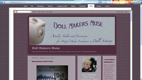

How can I deal with the [big] banner that is overpowering an iframe- embedded blogger blog ?
  • 1
  • Question
  • Updated 8 years ago
  • Answered
How can I deal with the [big] banner on a page I've used to embed a blogger blog with iframe? I like the banner on every other page, but it's just way too large. Even if I were to make the banner transparent, the blog is too far down. What can I do? please see my website, dollmakersmuse.com, the page is blog (it's still a bit of a mess, it's not done yet) Thanks!
And also, I can't figure out what size to tell the blog to be.
I changed the width to 1200 px but it looks weird.

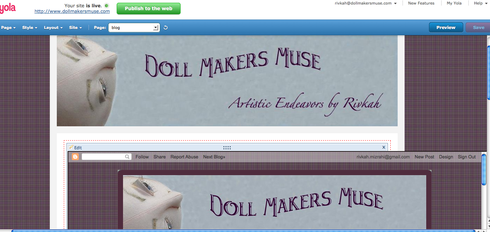

I just tried to view the page through "edit website" on yola, and this is what I see:
Is there any way to get it to look the way you have it above, but without all the white?

No, you won't see it on your side. This is using tools that allow a remote person to play with the pages but not affect anything on the published site. It's like a proofing tool. When it's all up to scratch then I'll copy down the code and give you instructions on how and where to place it.
I'll do that in a few hours time.
wrt the white horizontal borders, I think I can et rid of that. I'll work on it later. and get it to scratch. I see that I have to try and add back a bit of a border at the top otherwise it will look a little truncated.
Your menu won't be centered it will be left justified as it appears above. The alterations will only affect your blog page and no others. OK?
Must go. Speak later.

Photo of Gop
Gop
  • 7473 Posts
  • 2115 Reply Likes
Place the code on your Yola page and not in your external blog.
It's a one step process hopefully. The code that you used to place your blog into you yola site remains.
If you have created the page as a 'blog' style page rather than a normal page, I would delete it and createit as a standard page. There is no advantage in creating this as a blog type page as you are not creating any posts within this. The blog style page has a limited functionality and is very difficult to edit subsequently.
Photo of Rivkah Mizrahi
Rivkah Mizrahi
  • 51 Posts
  • 0 Reply Likes
Oh of course, that makes sense.
I went ahead and put it into the page, and it did take away the banner. But the blog is not aligned, and there is html code where the banner was
Photo of Gop
Gop
  • 7473 Posts
  • 2115 Reply Likes
OK. It seems as if you have duplcaited some code.
Can you take out the widgets except for your iframe. Your iframe code should remain.
Then add an (one) HTML widget with this code only:
<style type="text/css">
#page {
-moz-border-bottom-colors: none;
-moz-border-image: none;
-moz-border-left-colors: none;
-moz-border-right-colors: none;
-moz-border-top-colors: none;
background: none repeat scroll 0 0 #FFFFFF;
border-color: -moz-use-text-color #F3F3F3;
border-right: 20px solid #F3F3F3;
border-style: none solid;
border-width: medium 20px 20px;
margin: 0 auto;
padding: 20px 0 0;
width: 1200px;
element.style {
background: none repeat scroll 0 0 transparent;
#sys_banner {
height: 0px;
margin: 0px ;
width: 1200px;
#logo {
border: 0px solid #F3F3F3;
height: 0;
margin: 0 auto;
width: 1200px;
</style>
After pasting it into the widget and saving then it may be a good idea to see if the code is as it should be with no additional pieces of code added. If so then edit them out.
Basically what this does is to build the format of your page without any additional stuff being added. Your navigation and background remains in place and nothing else. The re-formatting has accommodated your external blog width of 1200 pixels compared to the default width of the centre part being approx 970 pixels. I see one thing I don't like and that is the dual vertical scroll s. One on your blog and one on your Yola page but at this stage I don't know how to rid the page of one or the other.
Hopefully this is what you want.
Rivkah Mizrahi
  • 51 Posts
  • 0 Reply Likes
Hi Gop,
I tried it out, and it's almost there.
Here is what I see now.... the problem is that the only thing you see is the banner and you've got to start scrolling to see the blog
Photo of Gop
Gop
  • 7473 Posts
  • 2115 Reply Likes
OK,
If you can amend the code in the first section of #page, just after
width: 1200 px;
and the first occurrence of
create a free line by hitting enter
and add into that empty line
height: 900px;
let me know how that goes?
PS: You could probably substitute that with
height: auto;
Photo of Gop
Gop
  • 7473 Posts
  • 2115 Reply Likes
No forget the auto. That won't work.
have you made any alteration to your iframe or your Blogger blog height at all?
That's probably the most likely reason.
Photo of Gop
Gop
  • 7473 Posts
  • 2115 Reply Likes
I can see that you have by the border around the frame. Just bring back the original settings and it should be OK.
Rivkah Mizrahi
  • 51 Posts
  • 0 Reply Likes
i did not alter the height of the blog
Rivkah Mizrahi
  • 51 Posts
  • 0 Reply Likes
What are the original settings?
I'm so embarrassed... I don't know what you mean :-)
I think I would rather cut whatever is in the widget out, and replace it all with the correct code (even if it's just one line being adjusted within all the code)
Can you please tell me what to erase and what to replace it with?
Thanks so much and please excuse my lack of knowledge
Rivkah
Photo of Gop
Gop
  • 7473 Posts
  • 2115 Reply Likes
OK.
I suggest creating a new page and calling it "alternate"
Bring in your external blog s you have done previously. (I do not know how you imported your blog originally onto the Yola site but you would need to repeat that.)
Then add an HTML widget onto the page and add this code but please Copy the code into Notepad first then Copy from Notepad and Paste it into the HTML widget. This will remove any inadvertent format code.
#page {
margin: 0 auto;
padding: 20px 0 0;
width: 1200px;
element.style {
#sys_banner {
height: 0px;
margin: 0px ;
width: 1200px;
#logo {
height: 0;
margin: 0 auto;
width: 1200px;
</style>
We may have to tweak this further but need to see the clean outcome first.
Photo of Gop
Gop
  • 7473 Posts
  • 2115 Reply Likes
