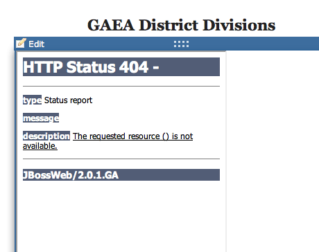

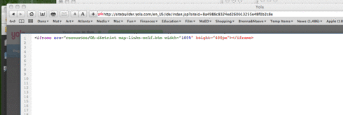

I followed your suggestion earlier and inserted this code:
Here is what shows when I save the code:
Photo of Sanja
Sanja, Official Rep
  • 10698 Posts
  • 495 Reply Likes
Hi Dana,
Your code is missing an " after your file name.
It should be as follows:
<iframe src="resources/yourimagefile.htm" width="100%" height="400px"></iframe>
Please also be sure that you're entering the file name exactly as how it's displayed in your File Manager.
