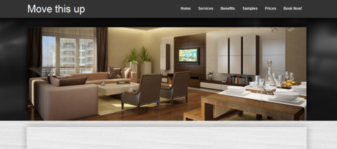

Thanks for creating that test page.
Do you want it like this:
If so, I have the code.
If you have Yola Silver, put this piece of CSS in your Site CSS (Style > Edit Custom CSS):
#sys_heading {
margin-top: -54px !important;
If you don't have Yola Silver, put this code on all of your pages in an HTML widget:
<style type="text/css">
#sys_heading {
</style>
I hope this helps.

Photo of Nathan
Nathan, Champion
  • 3739 Posts
  • 307 Reply Likes
Just add that CSS above (the second code, not the first) to an HTML widget on the pages that you want the header's position to change. It will change the position of the header when you add that code in an HTML widget. (it can be at the top or bottom of the page, but I suggest the top of the page.) If you don't see it once you add the code, try saving and previewing the page.
