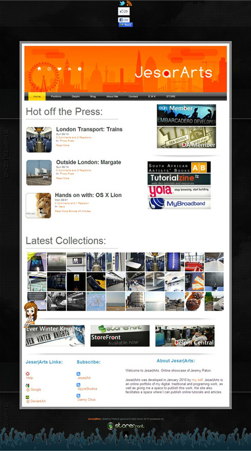

Hello everyone.
A few days ago during testing of a redesign to my site, on multiple browser types including mobile browsers, I may have discovered some kind of bug.
I first noticed it on my Windows Phone 7 which uses a scaled down Internet Explorer 7. Then when testing my site on Adobe's Browser Labs I found the same issue.
It would appear that the custom CSS overrides which my site heavily requires seem to simply be ignored in IE7. The standard Yola CSS runs fine, but non of my own CSS seems to be used.
I know IE7 is old, however, I still don't understand this as only a few weeks ago my site was displaying fine on my Windows Phone 7. So I am wondering if Yola has changed something?

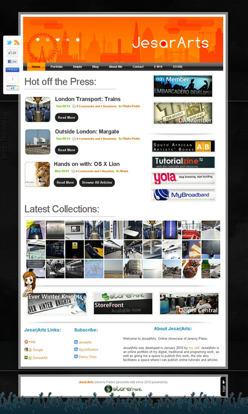

With CSS: Chrome/EI8+/Safari
Without CSS: EI7
