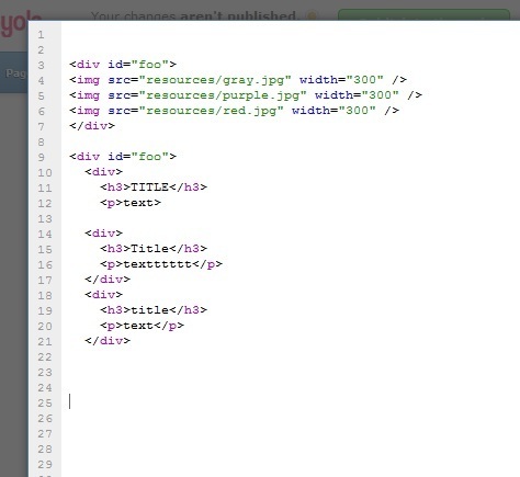

I'm having problems with fireing the plug in. I saved the jquery files in file-manager and I've tweeked html to suit my req.

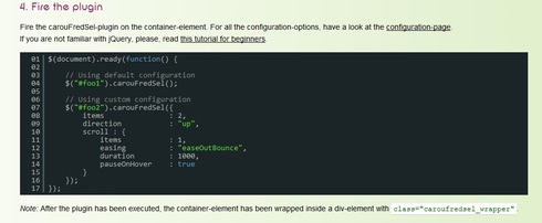

I basically followed the installation process on caroufred, but am now stumped on where to add the FIRE PLUG-IN code.
I added some code in CSS and had a play, but I feel like I'm in the wrong place... it should be pretty straight forward, but I'm just not sure on how to get around it. I've attached the code that I've added in an html widget... please see attached..
the other attachment is the actual jquery fire code, taken from the caroufred site...

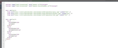

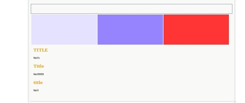

I've attached 3 jpgs. these show both html widgets I'm using, and the outcome when viewed in sidebuilder.
I'm hoping someone will be able to find the issue... :)

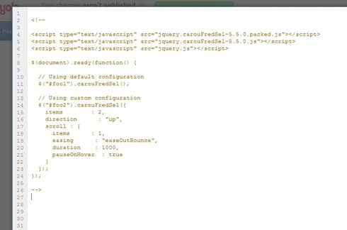

I've made a few alterations, only have the 1 caroufred source in the top code.. instead of packed and the other version..
MAIN ISSUE: I'm still not sure where to put this proportion of the code, as it's not being recognised by the html widgets... unless I close it with <!-- and --> then it turns a golden colour and ..... ?
where do I put this....???
$(document).ready(function() {
// Using default configuration
$("#foo1").carouFredSel();
// Using custom configuration
$("#foo2").carouFredSel({
items : 2,
direction : "up",
scroll : {
items : 1,
easing : "easeOutBounce",
duration : 1000,
pauseOnHover : true

Thanks for your patience. I believe you might need to wrap your jquery code with script tags or style tags. For example:
<script>your jquery code goes in here </script>
I hope that helps get you started in the right direction. Hopefully other forum members who are well-versed with these type of coding questions will be able to hop on and assist.

ok, so I added the tags... and it seems that the code is now being accepted into a widget, rather than just showing as random text in the html widget.... thanks...
However... there must be further complications with the, as there is still nothing happening to my images. :(
I will be patiently waiting for the Yola html ppl to look at this or any one else who feels they can issue tips... *cant wait to get it working...
