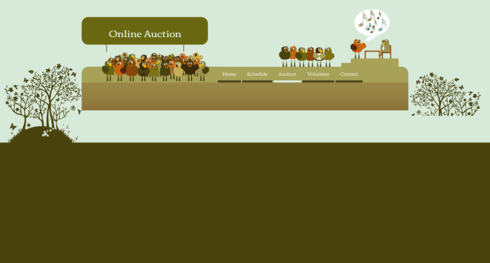

I'm using the Premium style "Social Birds", and you'll see that (at least in Google Chrome) clicking on any menu item on the website www.birdmigrationcelebration.org, the navigation menu is pushed to the right, and some items are bumped to the next line. I really like this template and would like to use it. Can you please fix it?

Hi! That CSS code change fixed the link problem with the Schedule menu item - thanks! But the problem of the shifting navigation menu still persists. I've attached a screenshot.
Photo of Gop
Gop
  • 7473 Posts
  • 2115 Reply Likes
It's exactly the same issue Rebecca.
Changing the CSS will stop this happening. I see you added embedded CSS. I would add preferably to the CSS over-rides. I can still see an issue with the Home page in that you can't select the Schedule nav.
after applying the altered CSS.
It doesn't appear that you have changed the padding from 130 px to 30 px in the code i sent previously. This I think is the blocking aspect.
