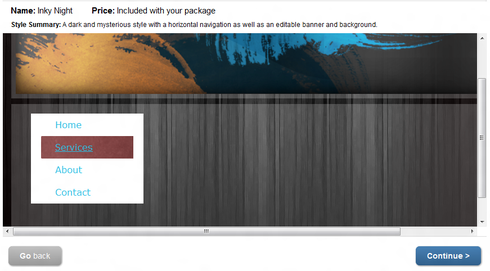

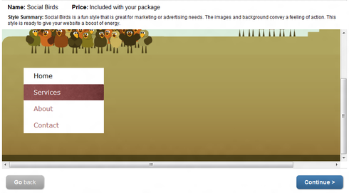

I am having trouble trying to implement a menu that I built with cssmenubuilder.com. It shows up fine in some templates but the one I want to use (Inky Night), has it all jumbled looking. Any Ideas

I think that you may be attempting to place the code in your CSS over-rides? Possibly what's happening is that the hardwired divs of the inkynight template are too restrictive for your menu and it's forcing the displayed menu in to other places it fits. I would also check the code that you are placing in inkynight just to triple check that some element hasn't been screwed.
Without seeing the outcome I would think that you may have to manipulate the existing DIVS of Inkynight. A laborious and non-recommended process. It's not something that Yola could support you with and it could crash I daresay.
I would look at a less complex style and use the background images of inkynight to place in another less marked theme.

Here's what it's supposed to look like.
Here's what it looks like.

As it is showing I can't see that it's all jumbled?
At first I thought the background was missing but you were comparing two themes :)
I think that they are both showing correctly and taking the CSS fo the text menu from the style CSS.

I guess my I didn't give you a very good picture, sorry about that.
I put black dots on the ends of the background image to better show what it's supposed to look like.
Here's the background image
Here's the examples
