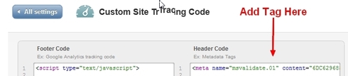

I just saw another way to verify metadata . Go to “Site” “Site Properties” “Site Tracking Codes and Edit. Which method would be best to use?

Just to let you all know that we recommend that you use the Tracking Codes rather than the field for the CSS...

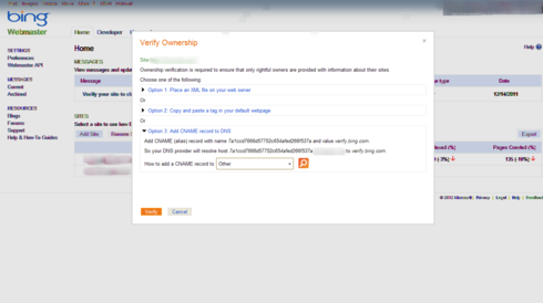

To verify your site with Bing there is a third method Add a CNAME record to your DNS. I think that this may be the only working method for Yola Bronze hosted sites. The meta-tag addition to the Header Code in Custom Site Tracking Code is the most straight forward procedure for Yola Silver hosted sites.
This process gives you an encoded record to add as a CNAME. There are specific instructions for various registrars. It is similar to the system that Google now uses as a verification option with GApps.
I have successfully verified three sites with this method but of course you cannot verify Yolasite sub-domains as there is no DNS management available for yolasite sub-domains to the user. I don't know if the Support people could add this for people with yolasite sub-domains.

I have tried the DNS and CSS editor both failed, to change CSS you have to be silver ???
Never had this problem before Yola took over from BT on GBBO
I add code to CNAME, second empty box along but what goes into the 1st empty box, if I put the code in there and update it says I never done anything to save.
Photo of Gop
Gop
  • 7473 Posts
  • 2115 Reply Likes
First empty box you add the long code. In the second box type: verify.bing.com
See this thread http://forum.yola.com/yola/topics/ver...

The current method with Bing is to add a cname record to the dns.
